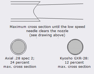

The top right picture shows the idle needle of an  Axial .28 Spec 2 and of the GXR-28 below. You can clearly distinguish the spheroidal cut of the Axial needle from the conical cut of the GXR needle. The Axial needle starts with a diameter of 1.4 millimetres, the one of the GXR with 1.5 millimetres. Both needles go into a 1.6 millimetre bore.
Therefore the needle of the Axial .28 can increase the nozzle cross section continually up to 24 percent before opening it completely while the GXR-28 needle will work only up to 12 percent.
This means a much harder transition into the mid -range for the engine because the fuel flow increases abruptly.
Obviously this cannot be compensated by the distinct conical cut of the GXR-needle because the transition mentioned before turned out to be a major problem in practice. The engine -more so than others- tended to be overly rich, although the carb was set according to the manual and the engine performed good under idle and high rpm conditions.
